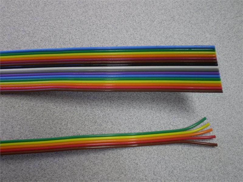

I always have a stock of rainbow ribbon cables (flat cables) for all sort of wiring.
2-3 meters of 40wire cable lasts for at least 4-5 synths
AWG24 for standard connections
AWG18...AWG20 for power connections
For connection to and from Mixer Section take a 3.5mm stereo audio cable and cut in 2 fitting pieces.
