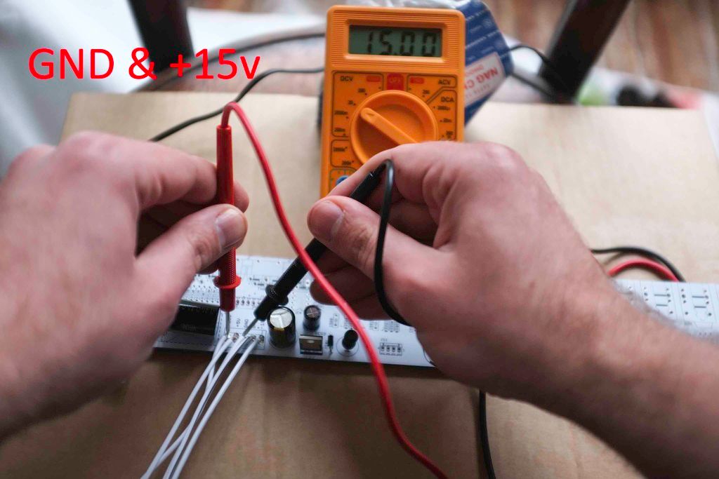

as the name of the thread makes clear, I'm attempting a Nava build with no previous electronics experience, and feeling somewhat overwhelmed, surprise surprise. I'm on the noise section and about to install my first transistors and chips. My problem is that I'm unable to find a -5 or -15 v current anywhere on my board, including the i/o. +15 appears where it should on the main board, but that's about it. Any advice? I don't dare install any of the non-generic parts before figuring out what is going on.

do you have +/- 15 and +5V on the IO board at the other end of the power cables?

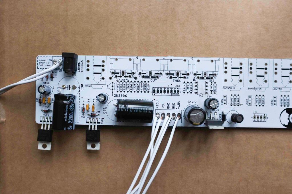

The soldering is ugly but functional. Can anybody suggest where the problem might be?

Most of your diodes are all the wrong kind!
Also D101 is in the wrong direction!
Thanks, I flipped the 101 around but no change to the voltages. The diodes were a replacement for others on backorder, but they are the same ones now in the BOM (512-1N4148)drifter7508 wrote:Most of your diodes are all the wrong kind!
No, they are not.
1N4004 are the right ones.
My mistake, thanks for the correction. I overlooked the packed and hadn't figured out the labelling system when I did the build. Will try and fix it up now
