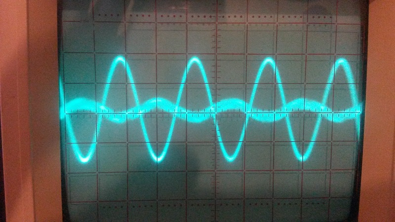

1st test (ba6110)
I applied 1.5Vcc to r374. I could hear white noise (at least noise
I placed a sinewave on r372, as far as I can tell, between c136 and r372.
I took the output on r296.
probably I am missing something, because the was different than I was expecting.
Please have a look: Always looking for something doing "the overdrive (saturation or what else)" I did test from r377 to r296 to see if u19 was gone.

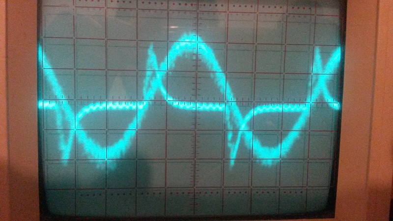

2st test (OPA)
Sinewave on r372.
Please have a look, u19 sounds good to me.
