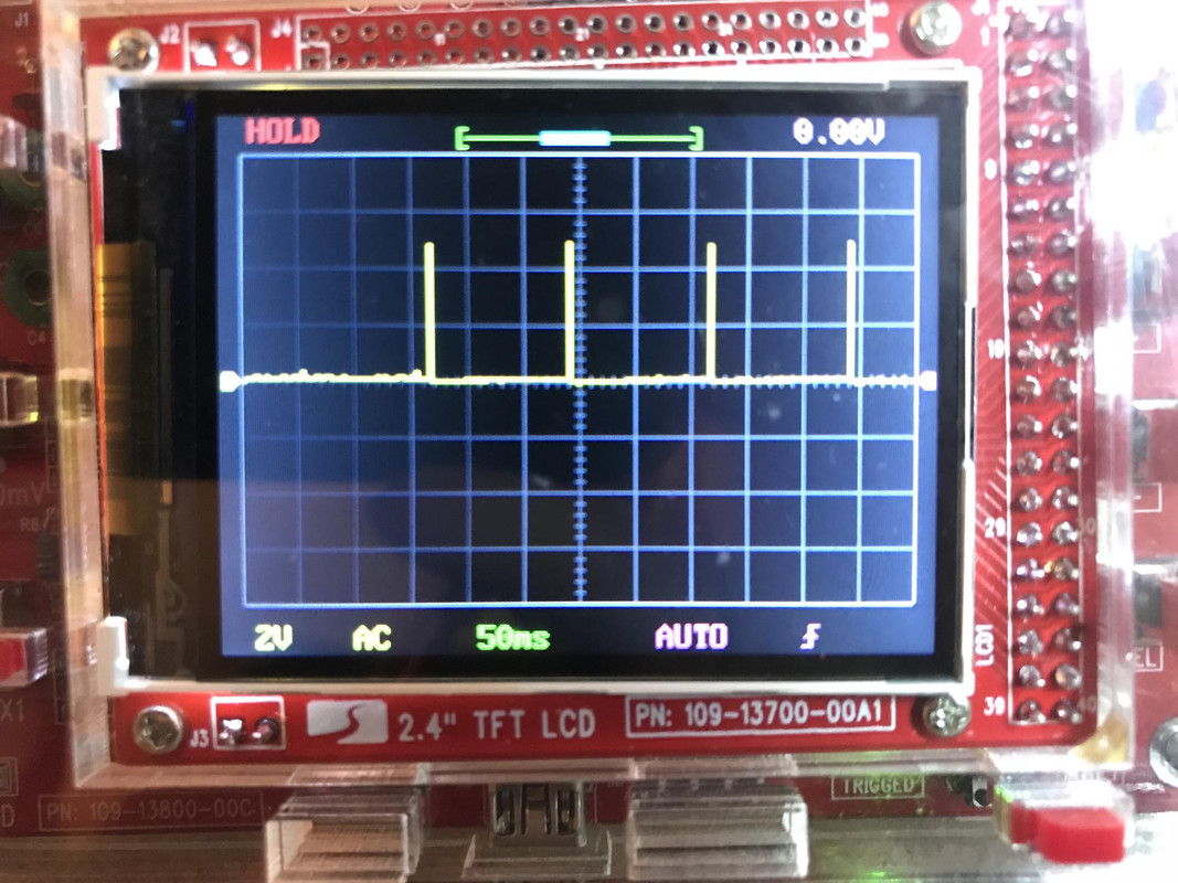

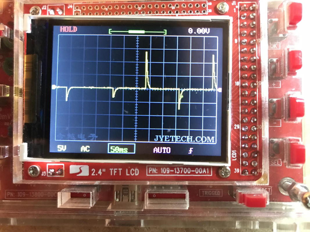

Here are the other measurements of the Rimshot voice :
TRIG point
ACC point
ENV point
F1 point
F2 point
F3 point
What should be the next thing to check ??
