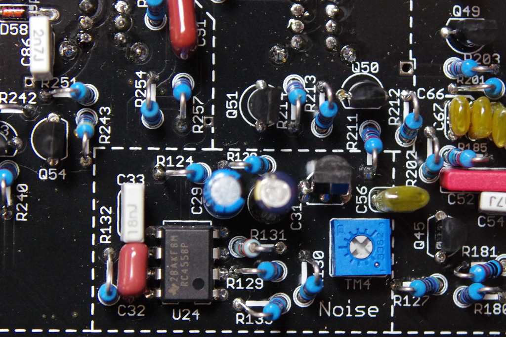

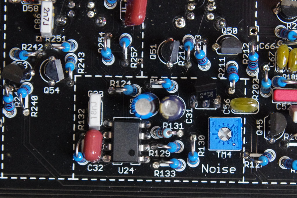

Hi,
I have the same issue with the Noise section...
I have two built Yoctos, and with one I cannot get below 700mV AC on Pin 1, and with the other Yocto, range is btw 16mV and 20mV AC.
I built both Yoctos in parallel, so that is really weird...
Both 4558 are properly powered (approx. +15v/-15v)
On the first Yocto, the consequence is crappy-sounding Cymbal, Clap and Snare
On the second Yocto, same thing, with nearly no decay on the clap and on the Snare.
Here are pictures of the two Noise circuits :
First Yocto (700mV AC) :
Second Yocto (20mV AC) :
Thanks in advance for you help!
